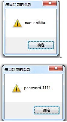

三、遍历JSON对象
myJson = {"name":"nikita", "password":"1111"}; for(var p in myJson){//遍历json对象的每个key/value对,p为key alert(p + " " + myJson[p]); }
运行结果:

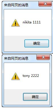

四、遍历JSON数组
packJson = [ {"name":"nikita", "password":"1111"}, {"name":"tony", "password":"2222"} ]; for(var p in packJson){//遍历json数组时,这么写p为索引,0,1 alert(packJson[p].name + " " + packJson[p].password); }
我更倾向于这种写法:
for(var i = 0; i < packJson.length; i++){
   alert(packJson[i].name + " " + packJson[i].password);

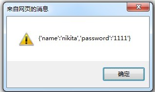

 五、将两个JSON对象组装到一个里面
//targetJson 目标JSON,packJson 被组装JSON function addGroupJson(targetJson, packJson){ if(targetJson && packJson){ for(var p in packJson){ targetJson[p] = packJson[p]; } } }
用法如下:
var json1 = {"name":"nikita"};
var json2 = {"password":"1111"};
addGroupJson(json1, json2);
alert(json2str(json1));
运行结果:
